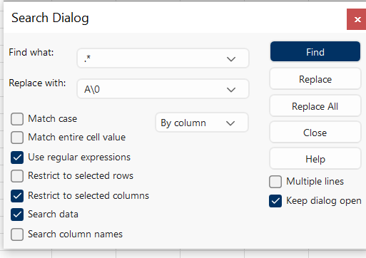

Craige_Hales
Re: Add a character to each row in a JMP column
If you are comfortable with regex, you can use find/replace to do it; .* matches the content of each cell and \0 refers to the entire match.

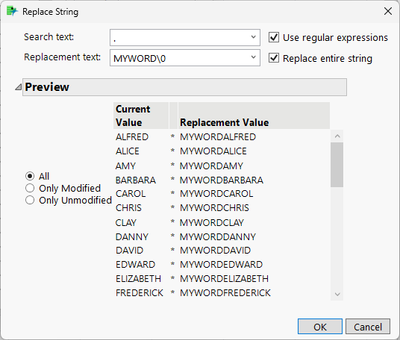

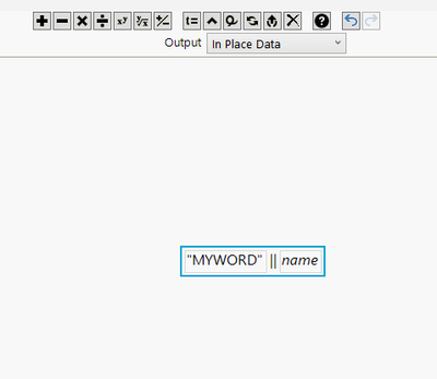

jthi
Recode can also be used for this with Replace String
You can also do this by using new formula column and replace data in place
-Jarmo

Craige_Hales

jthi
-Jarmo
