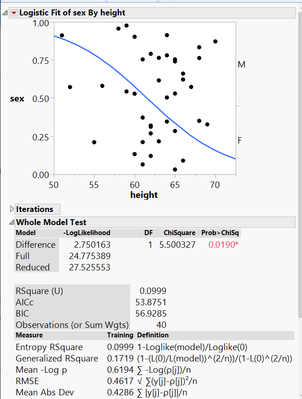

Hello users,
How do I remove graph summary statistics using JSL?
This is the ouput.

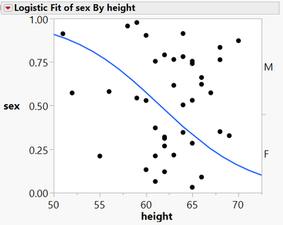

Here is the desired output:
I want to do this using JSL. Here is my simple JSL script to generate the graph from Big Class.JMP data:
