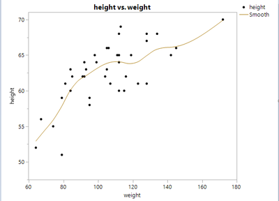

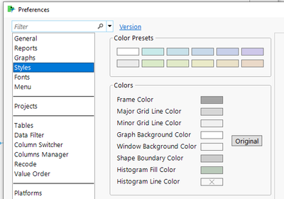

When outputting the graph itself using Graph Builder, if you select the selection tool and copy and paste the graph or axes, a shaded area appears around the graph and axes, as shown in the image. In the environment settings, we have set the background to white as shown in the photo, but the shaded areas still appear using the above method. Is there any other way to make the shaded areas around the axes white?

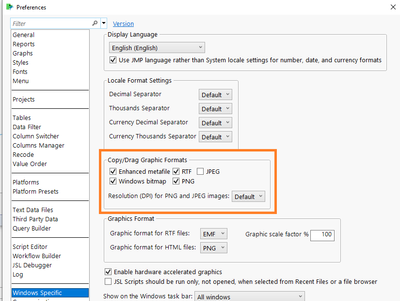

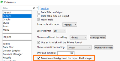

I can see your .png. I know this has been an issue at somepoint with JMP, but I cannot replicate it with JMP 18.2.0. Do you have this enabled which was shown in the video?
These are my settings:
Transparent background for report PNG images enabled
Styles
Windows Specific

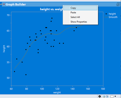

If I select graph builder, right click and select copy
It will come out as
to paint for example.
-Jarmo

Thank you for your answer. I did not check " transparent background for report PNG reports".
I could do it. I appreciate you.
