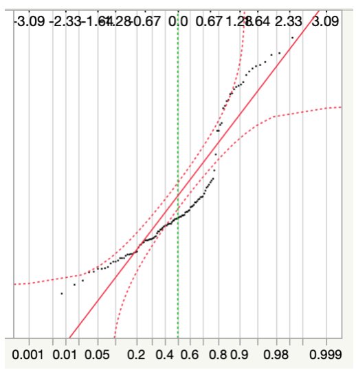

While doing quantile plot analysis i am seeing all data points with "data labels" as like below. Hence i could'nt able to see the curvature of data points. please refer below image
Also i am seeing the particular column with some symbol as like below. I dont know how to remove this symbol. If it is removed, will that data labels also remove?
Below is my expectation.

Try selecting all the points, right-click and select Row Label to remove the labels (https://community.jmp.com/t5/Discussions/data-labels/td-p/11268). Does that help?

Can you also explain about the below symbol? It is not clear to me how it has come?

That is the "Use For Marker" symbol.  It appears/disappears when you right-click on the column name in the Columns Panel and select "Use For Marker."  When selected, the values in the column will be used in place of dots in reports.

This helps a lot now. Thanks Hadley.
