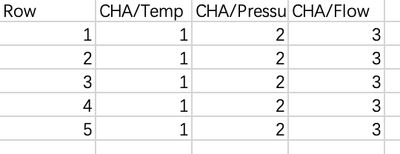

For example, I have a table:
1. All column names contain "CHA/", how could I remove it quickly and leave it like "Temp""Pressure" and "Flow"? In the real case, I have hundreds of columns containing "CHA/".
2. How could I make the first row as the column names?
3. Is there any way to remove "CHA/" from all the cells in the table?
Thank you!

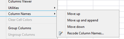

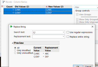

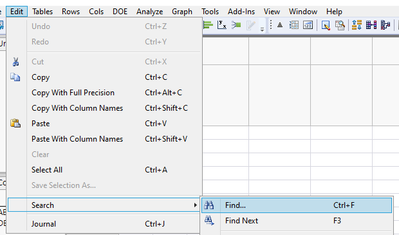

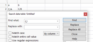

jthi
Re: How to remove a user-defined text from all columns or all column names?
1. You can use Recode Column Names to clean those
2. Top row to column names
3. Yes, either by scripting or using Search dialog and replace all
-Jarmo

jthi
-Jarmo
