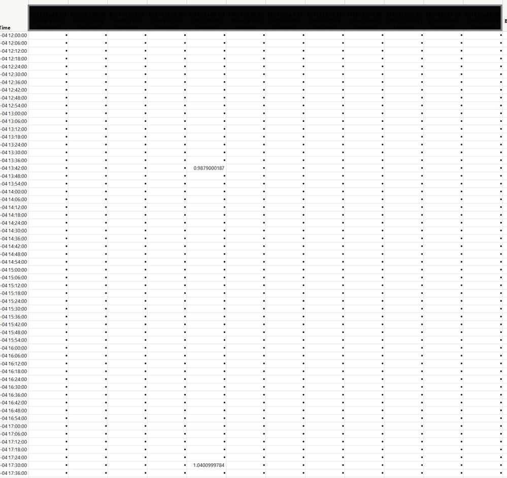

No, we are not plotting all the columns at the same time. We want to make one IMR chart per Grade|Property. Since each Grade and Property has different specifications, have to split the dt by Grade|Property. This results in many sparse columns. See snippet below for just one property for 12 Grades. Control Chart Builder does not like all the blank rows.

Re: How to query a large data table based on a column level and return columns whose name contains that level?
Situation might have changed since 2021 but this post discusses some options regarding missing values in control chart builder How to draw Control Charts that ignore missing data?  (and of course via scripting there are plenty of different options).
Edit: Quality and Process Methods > Control Chart Builder > Excluded and Hidden Samples in Control Chart ...
