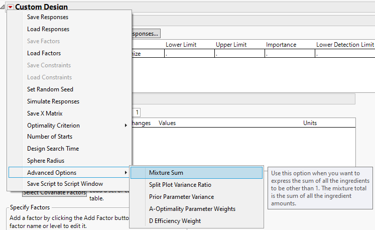

More details are likely needed. But if you are using Custom Design to create your mixture design, go to the red triangle pop-up menu and choose Advanced Options > Mixture Sum.

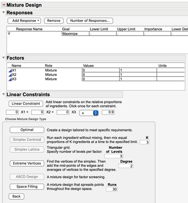

First, welcome to the community.  I'm not sure I understand exactly what you want and from which platform you are using to create your mixture design, but you can certainly do linear constraints and set the value after the ≤,≥ sign in the DOE>Classical>Mixture Design platform:

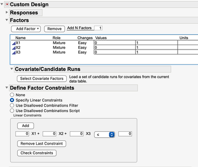

You can also do this in the Custom Design platform after you have added your mixture factors.

The command is buried a bit. Here it is:
Re: How to put the mixture sum below 1?
