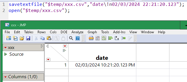

I suspect the fix will be on the database end, not the JMP end, for example, https://database.guide/how-to-return-fractional-seconds-from-a-datetime-value-in-oracle/ , possibly specific to the database brand.
As a work-around, you might export CSV from the database, though it might need the same fix.
Imports the fractional seconds OKImports the fractional seconds OK
edit: that might be less than clear; "on the database end" still means editing the query to make the database send the data.
