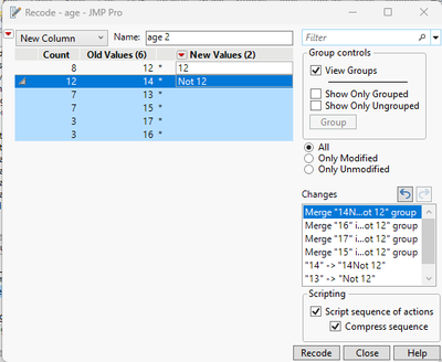

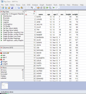

All you need to do is to create a new column, and in the new column.  Try using Recode to do that

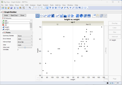

Here is an example using the Sample data table Big Class.  The objective is to display all 12 year olds vs all non 12 year olds.
Then open Graph Builder and create your graph.  Then drag the new column Age 2 to the X Group drop area

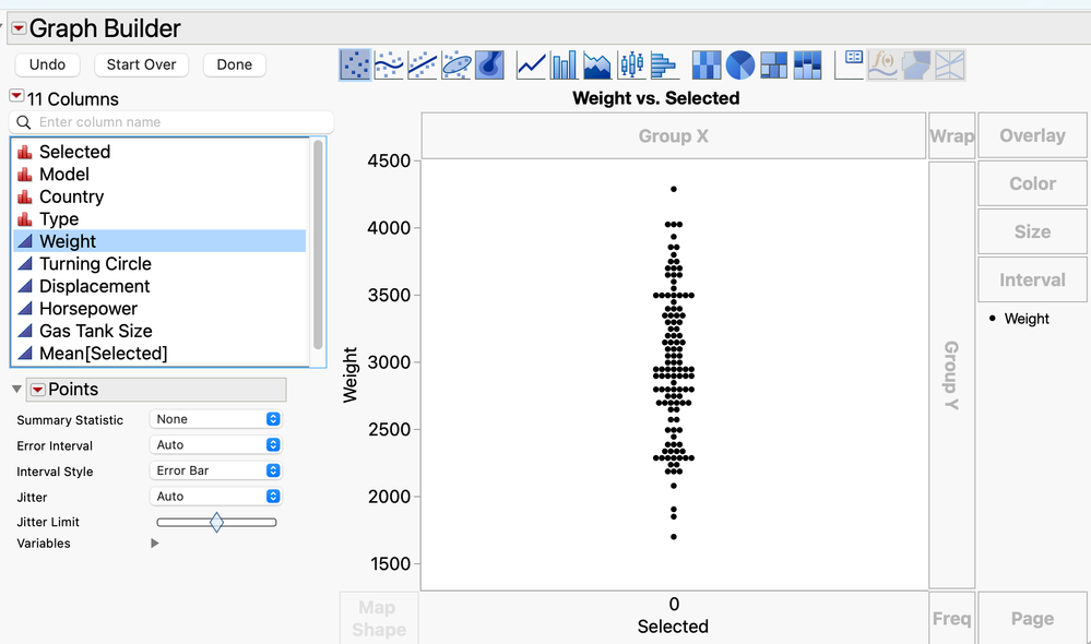

As a dynamic extension to what Jim recommends, my favorite way to do this is as follows:

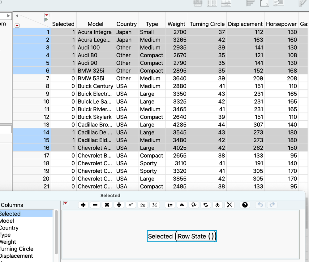

1) add a new column to the table, name it "Selected", make it nominal, and add to it the formula
Selected ( Row State ( ) )
This column will have 1 for any selected row, and 0 for any unselected row, and will update automatically as you make various selections.

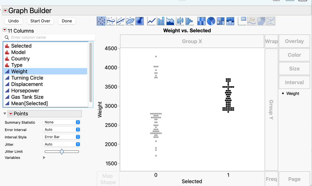

2) In graph builder, drag this new "Selected" column to the x-axis.
If you have no rows selected in your table, you'll get something like this:
3) As soon as you select anything (even within this very graph), you'll get this:
Exactly HOW you make the selection, is completely up to you. You can make the selection whatever you wish, and you'll always see what you've selected, vs everything else.

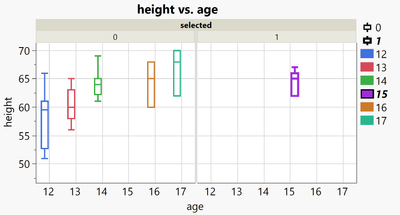

And if you want to compare one group with many others, you could put the selected() into GroupX to separate the selected group clearly from the other 5.
Names Default To Here( 1 );
New Column( "selected", Numeric, "Nominal", Formula( Selected() ) );
Graph Builder(
	Show Control Panel( 0 ),
	Variables(
		X( :age ),
		Y( :height ),
		Group X( :selected ),
		Overlay( :selected ),
		Color( :age )
	Elements( Box Plot( X, Y, Legend( 14 ) ) ),
