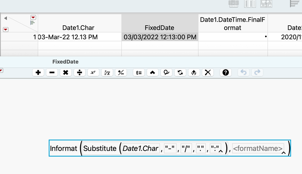

Hi Altug,
I hope you are well--it's been a long time!
I am assuming you are doing this by scripting. JMP can handle many date and time formats natively. When this is the case, the Informat ( ) function is great, because it converts a string to a time.
Your date is pretty close to a native format. 03-Mar-22 12.13 PM is not a native format, but 03/Mar/22 12:13 PM is !
So, all you need to change is your dashes to slashes  ( "-" becomes "/" ), and your period to a colon ( "." becomes ":" ).
The Substitute ( ) command can do this for you. Once this is done, you can wrap that in an Informat ( ) to get a numeric date. All that remains is to apply your desired display format, which is a Locale format.
So the process is to write a new column that:
a) has a formula that wraps an Informat ( ) around a Substitute ( ), and
b) formats the output to look like you want, while still retaining the numeric date underneath.
Let us know how this goes,
Brady

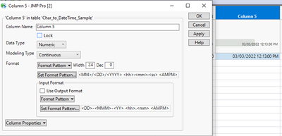

altug_bayram
Level V
Re: Character to DateTime Conversion Help Needed
I have JMP 16 and It did not work. Below are my steps. Would appreciate if you can point to a mistake.
First I put a formula (that was forgetten earlier) into
Date1.DateTimeFinalFormat = Date1.Char
Set Date1.DateTimeFinalFormat date type/modeling to Numeric and Continuous
Set format to Format Pattern
Uncheck "Use Output Format"
Set Format Pattern
<MM>/<DD>/<YYYY> <hh>:<mm>:<ss> <AMPM>
On Input side, Set Format Pattern
<DD>-<MMM>-<YY> <hh>.<mm> <AMPM>
to which an error is issued:
altug_bayram
Level V
I also changed HH to hh and AMPM to ampm on input side..
At one point, it accepts the format and then returns Date1.DateTime.FinalFormat column back to Character.
