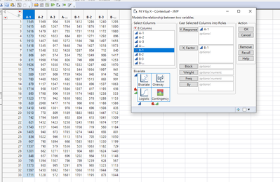

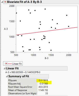

try to plot many fit by x plots and find the RSquare from each linear fit. How can I do it at once? (make all plots and do the linear fit at once)
1. select item to plot: A-1 vs B-1, A-2 vs B-2 ... etc.
2. Linear fit and find the RSquare

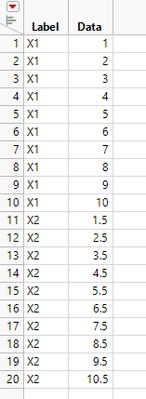

Here is the data
Then "stack" your X variables. Check out menu item "Stack" Under "Tables". In the dialog, uncheck "Stack by Row", check "Drop All" as indicated in the following screenshot.

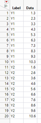

Do the same on your Y variables and you get this:

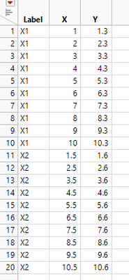

Now, you put them side by side. A copy-n-paste will do. And rename the columns. Get this:

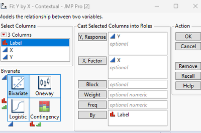

Now fit your regressions by Label:

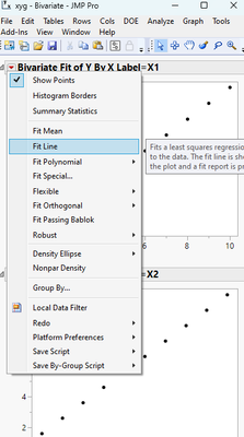

When you do the fit, remember to hold the Control key when you click menu. This will fit model to all By-groups.

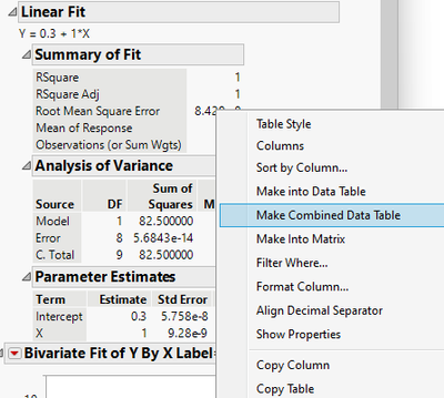

Now right click on the interested number, select Make Combined Data Table.
Now you should have a bunch of numbers in the generated table, but in an organized way. You can select, subset to get what you want.

The Fit Line, etc. can then be run.  By holding down the CNTL key as you select Fit Line or any of the other options, the selection will be run on all graphs.
