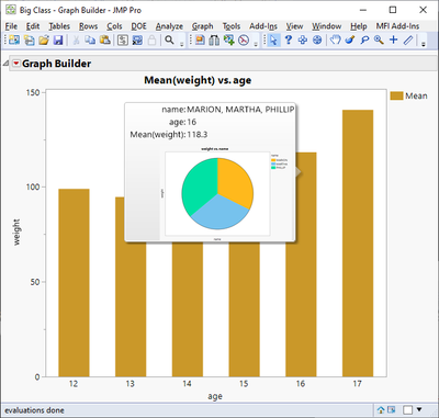

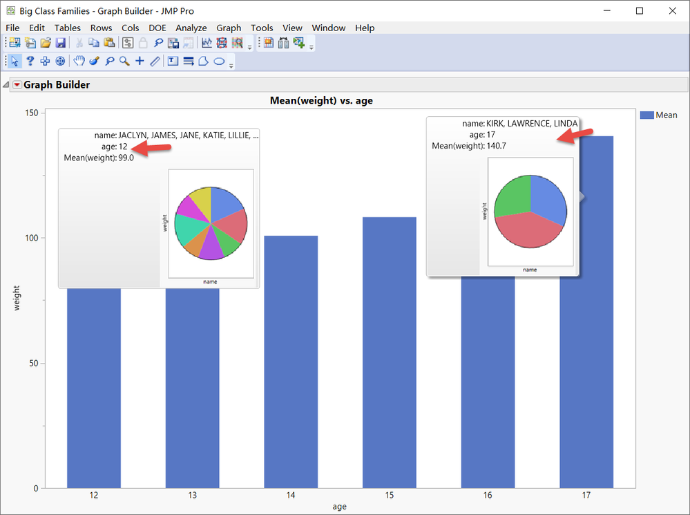

lala
Level IX
Re: How to pass parameters to the specified JSL in the graph fetch?
You run the above JSL,
The cursor hovers over the graph, gets the "age" parameter, and gets the pie chart via hllib.jsl.
No pie chart appears without hllib.jsl.
So I think it's passing the age parameter.
I want to know how this example works.
Thanks!
jthi
Age is found from x-axis so it will be shown in the hoverlabel
Names Default To Here(1);
gb = dt << Graph Builder(
	Show Control Panel(0),
	Variables(X(:age), Y(:weight)),
	Elements(Bar(X, Y, Legend(7))),
	SendToReport(
		Dispatch(
			"Graph Builder",
			FrameBox,
			{Set Graphlet(
				Picture(
					Graph Builder(
						Size(502, 435),
						Variables(X(:name), Y(:weight)),
						Elements(Pie(X, Y, Legend(10)))
-Jarmo

jthi
I have commented few times to you already, read the documentation regarding hover labels from JMP Help and especially
Work with the Hover Label Execution Context (jmp.com).
One way of seeing all the variables (to my knowledge) which you can access in hover labels local context, is to use Namespace("local") << get contents()
	SendToReport(
		Dispatch(
			"Graph Builder",
			FrameBox,
			{Set Graphlet(
				Picture(
					Show(Namespace("local") << Get Contents());
					Graph Builder(
						Size(502, 435),
Namespace("local") << Get Contents() =
	{"_filters", {:age}},
	{"_mode", "Picture"},
	{"_where", ":age == 17"},
	{"_age", 17},
	{"_name", "KIRK, LAWRENCE, LINDA"},
	{"_groupings", {:age}},
	{"_firstRow", 38},
	{"_Mean(weight)", 140.666666666667},
	{"_underlyingRows", 3},
	{"_measurements", {:weight}},
	{"_displaySegName", "BarSeg"},
	{"_dataTable", Data Table("Big Class")},
	{"_summaryStatistic", "Mean"},
	{"_drillDepth", 1},
	{"_xaxis", 0},
	{"_yaxis", 0},
	{"_customData", [=> ]},
	{"_localDataFilter", "Local Data Filter(Close Outline(1), Add Filter(columns(:age), Where(:age == 17)))"},
	{"_whereExpr", :age == 17}
-Jarmo

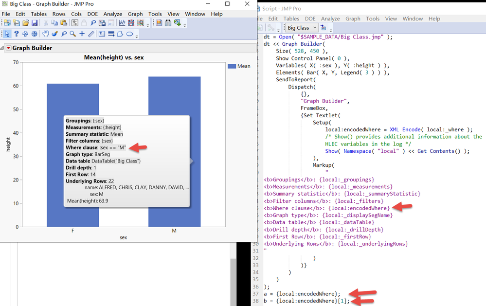

lala
Level IX
Yes, thank you for your patient help.
My understanding of scripts is limited.Never understood.
I am so that I can understand,
But it doesn't seem to work.
	Size( 528, 450 ),
	Show Control Panel( 0 ),
	Variables( X( :sex ), Y( :height ) ),
	Elements( Bar( X, Y, Legend( 3 ) ) ),
	SendToReport(
		Dispatch(
			"Graph Builder",
			FrameBox,
			{Set Textlet(
				Setup(
					local:encodedWhere = XML Encode( local:_where );
					/* Show() provides additional information about the
					HLEC variables in the log */
					Show( Namespace( "local" ) << Get Contents() );
				Markup(
<b>Groupings</b>: {local:_groupings}
<b>Measurements</b>: {local:_measurements}
<b>Summary statistic</b>: {local:_summaryStatistic}
<b>Filter columns</b>: {local:_filters}
<b>Where clause</b>: {local:encodedWhere}
<b>Graph type</b>: {local:_displaySegName}
<b>Data table</b> {local:_dataTable}
<b>Drill depth</b>: {local:_drillDepth}
<b>First Row</b>: {local:_firstRow}
<b>Underlying Rows</b>: {local:_underlyingRows}
a = {local:encodedWhere};
b = {local:encodedWhere}[1];

lala
Level IX
yes
I try
Set Clipboard( {local:encodedWhere} );
in JSL 18 row
	Size( 528, 450 ),
	SendToReport(
		Dispatch(
			"Graph Builder",
			FrameBox,
			{Set Textlet(
				Setup(
				Markup(
But it only get
