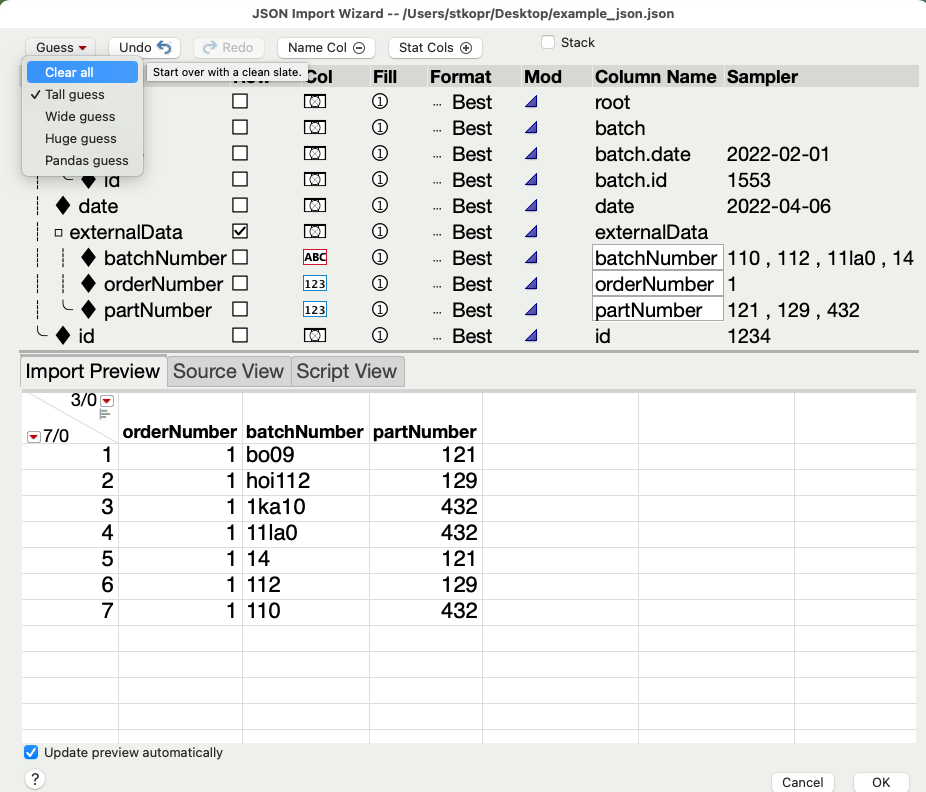

Depending on which version of JMP you are using you can import the JSON file directly into JMP using the File Open command.
Import JSON File-->OpenImport JSON File-->Open
Import JSON Red Triangle Option Tall FormatImport JSON Red Triangle Option Tall Format
Select the "Tall guess" option from the red triangle menu option.
And after clicking OK you get the JMP data table with a source script that you can reuse as needed for importing additional files.

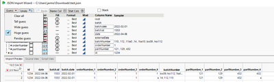

Depends on how you want the data to look like, it might be that JSON Wizard cannot format it like you want to.
JSON Import Wizard with Huge Guess (Wide will most likely also work):
Then you can separate batchNumber to different columns:

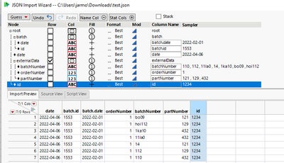

Or using a bit more complicated JSON Import Wizard settings:
And from here you can use different tools JMP offers to split/stack/transpose the data.

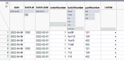

You could also leave batch.id with empty values and use that to calculate list index
If(Row() == 1, val = 0);
If(Is Missing(:batch.id),
	val,
	val
val;

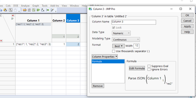

If my JSON data isn't a file but is a column in an existing datatable, how can I parse the JSON into separate columns? In the example screenshot below, I want to parse the "results" column out into 3 separate columns: result1, result2, result3.
jthi
Re: How to parse a list of JSON objects to separate columns?
Writing separate formulas for each of the results is one option
Parse JSON(:Column 1[1])["res1"];
