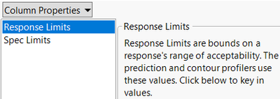

Are you referring to the Response Limits column property? It defines the desirability function for the response. It does not limit the range of the response value in prediction. How is this property defined for the two responses?

Hi Mark, thank you very much for your response. Yes, you are correct, the response bounds are defined in Response Limit column property and for both the responses, the properties defined are continuous and numeric. The description besides Response Limit Box refers (below) it as bounds on the response's range of acceptability, so I assumed JMP would find solutions considering the response bounds as constraints.
