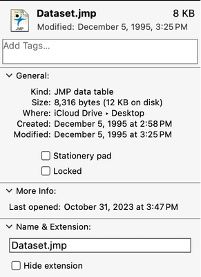

I just checked with my version I can open JMP files from 1995 (funny I tried to attach it, but it won't let me 
).  My Version 1 files would open, but the data was missing.
Can you attach a file you can't open?  What are the file names?
