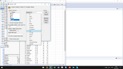

anyhow, try to use table summary, put the date in the grouping and ask for the sum of the numbers. this should give you the total of events per day.
