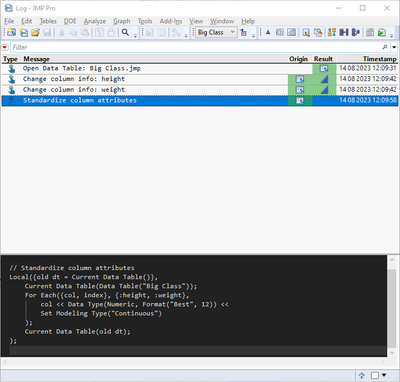

Easiest way is to select all columns and use Standardize Attributes
and then copy the captured script
Other option would be to use << Get Column Names("String") to get list of column names and then loop over that list while using << Data Type("Numeric") and << Modeling Type("Continuous").
-Jarmo
