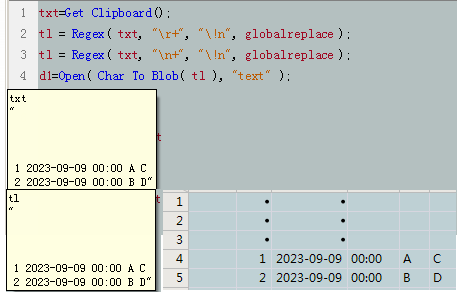

回复: How to make the content of the paste board into a table?
Can this be done with JSL?I am still using JMP14 and cannot record.
t1=Regex(txt,"\!n\!n","\!n",globalreplace);
Thank Craige!

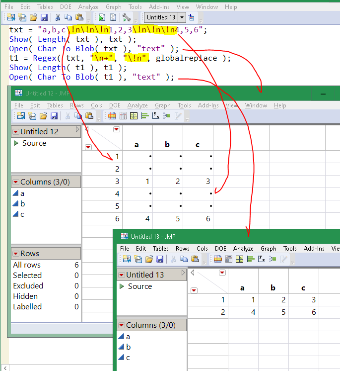

Craige_Hales
Sure, either save it to a file with a .CSV extension, or convert to a blob and open from the blob (and tell open it is a "text" file.)
Note the regex pattern uses \n for a newline and the regex replacement uses JMP's \!n.
change multiple consecutive newlines to a single newlinechange multiple consecutive newlines to a single newline
Craige

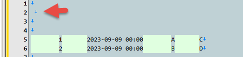

lala
Level IX
  • Cannot be implemented using copied data
Craige_Hales
on line 3, try changing txt to t1
The original text is likely to have CRLF pairs, but line 2's effect is lost by line 3 overwrite.
 you can also use the Hex(t1) function to see LF==x0A and CR==x0D
