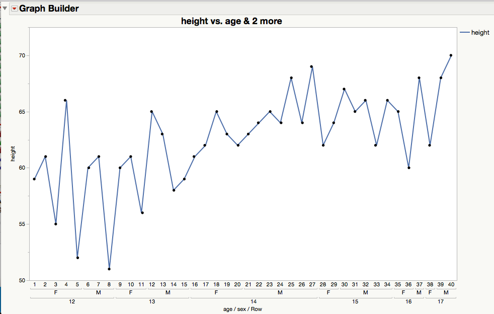

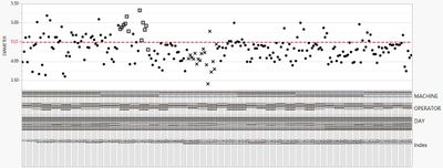

I want to create a "control chart-like" graph. Essentially, it is like a control chart, but the x variables can be as many as I like. It is like the graph I attached, but with a line passing through all the points.
Here are some solutions I tried but failed:
  • Variability Chart ==> I can't draw the connecting line across the points.
  • Line Chart ==> The x variable number is limited to two.
  • Graph builder ==> Too tedious with its unpredictable drag and drop mechanism. Also, my third variable is a date (numeric type) which is not added, no matter how hard I try to drag it at x-axis.
Any suggestions?

GraphBuilder is predictable once you get used to how the drop zones work. Take a look here. Running the script below shows the result in a simple case.

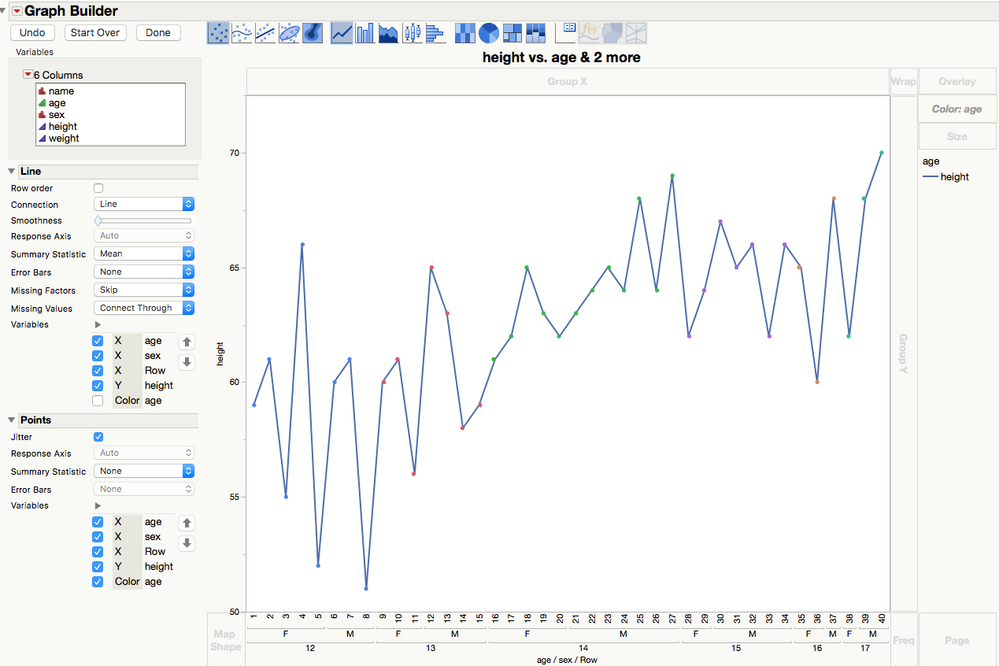

Using the example above, exposing the Control Panel and dragging 'age' to the 'Color' drop zone, I made:
The resulting legend is selctable.

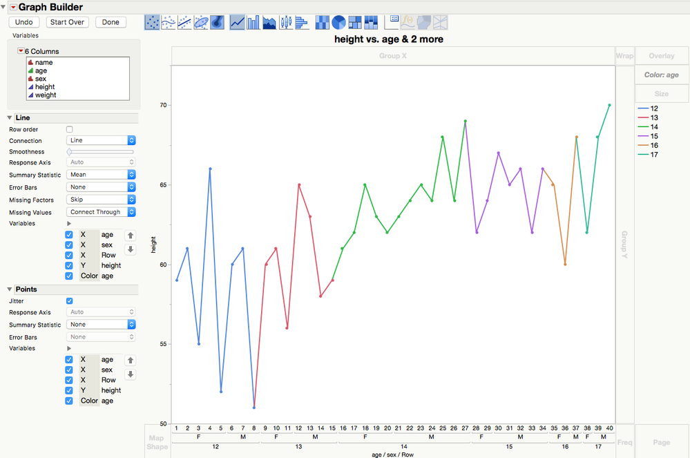

Then, looking at the options on the left and deselecting one, I made:
which (I think) is what you want
