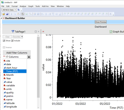

Thanks @danschikore and @jthi for your responses. It looks like I do not see the red triangle only when I try to build a dashboard on my own data table. When I try it on 'San Francisco Crime' data table, the red triangle appears! (see below). I tried it on some other data tables of my own but still the read triangle did not appear! Am I missing something here?! I am using JMP16.

Yes, I see the same issue using the 2x1 Dashboard template. See below the dashboard in preview mode:
I will contact JMP support.
Thanks.
