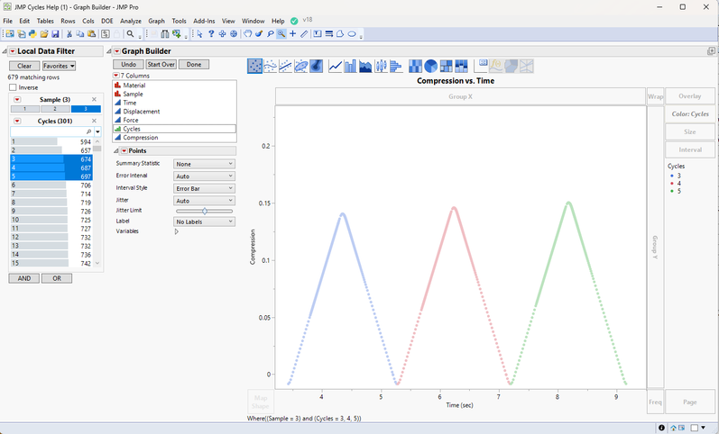

I added this formula to the Cycles column.  It increments the Cycle number each time it detects a change from decreasing values, to increasing values.
As Constant( x = 1 );
If( :Sample != Lag( :Sample ),
	x = 1
If( Lag( :Compression ) > :Compression & Lag( :Compression, -1 ) > :Compression,
	x = x + 1
x;
Below is a graph where I have created a local data filter, which is set to only display cycles 3,4 and 5 from sample 3.  I believe this is what you are looking for
