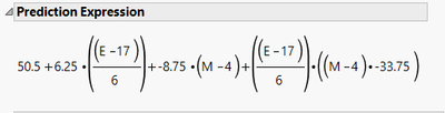

When I do a full factorial DOE, and get my model (variables are E and M, y is response).  When I let the model "show prediction expression", it gives me a equation like this:   y=
This is a not finished equation, it need you to calculate and simplify it further. I don't know why JMP do this weird things like this since for a statistic software, to give a final simplified equation is not a difficult thing, and yet JMP let me to do those further calculation. Even in Minitab, I can get a simplified equation, like y=a*E+b*M+c*EM+d*M*M+e (a~d are coefficients, e is constant).

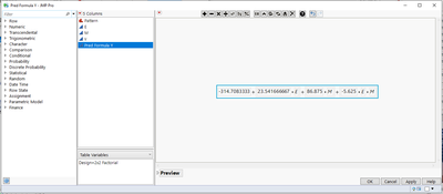

(-314.708333333333) + 23.5416666666667 * :E + 86.875 * :M + -5.625 * :E * :M

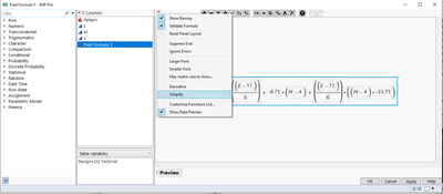

You can also go to the red triangle in the Formula Editor, and Select Simplify

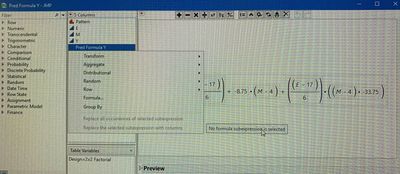

Thank you for your answer.  But my JMP 15 didn't have the simplify choice when I right click (see below picture), and I don't know how to use to script by adding text orders to script.  I don't know how to open the script editor, and I didn't find "how to open script editor" in the help as well. Could you please teach me how to open script editor and add the "Simplify Expr"
function to the script?  Thank you!

Sorry, I just figured out according to your answer after my last post.  Please forget my last post.
