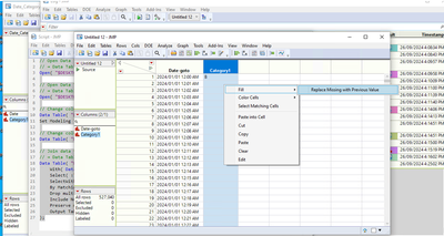

Hi @Ole_Luehn ,
I'm able to join the two table table & able to find the JSL code to fill & replace missing with previous value (this can be done through GUI too).

Pls refer to link below too since I can't really explain how the fill-in script works ;
https://community.jmp.com/t5/Discussions/How-to-replace-empty-rows-until-next-entry-and-continue/td-...
https://community.jmp.com/t5/JMP-Add-Ins/Fill-Missing-Cells/ta-p/460326

Hi. It worked - I downloaded this Add-In - and updated my merged file.
Thank you - now I can continue.
