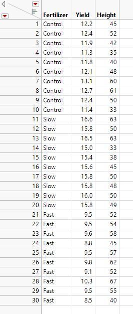

I have data above, and I consider Height as covariate, and I did Covariance Analysis.
First, I think the blue box is "adjusted mean" by covariate because actual mean for Control, Fast and Slow is 12.13, 9.41 and 15.83 respectively.

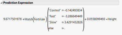

The easiest way to see what you want to see is to go to the red triangle and choose
Estimates > Show Prediction Expression:

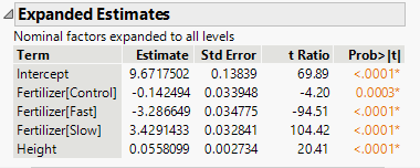

or from the red triangle choose Estimates > Expanded Estimates:
The way that JMP does the coding requires that the estimates of a categorical variable add to 0. Thus, the estimate for slow = -1*(control estimate + fast estimate) = -1*(-.142494 + -3.286649) = 3.4291433, not 0.

Thank you so much!! It's so clear!! I love "Prediction Expression" It looks like go good.
