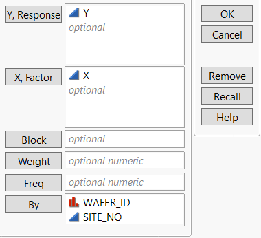

Hello, i am doing analyze the wafer using script. But eventually, my script only work when i manual plot first fit y by x using this selection. Can i know the script that can run automatically selected fit y by x using that selection?

txnelson
Re: How to insert fit y by x using script?
If I am understanding what you want, all you have to do is to change
Bivariate( Y( :Y ), X( :X ), Where( :WAFER_ID == ID_Wafer & :SITE_NO == 1 ) );
Bivariate( Y( :Y ), X( :X ), Where( :WAFER_ID == ID_Wafer & :SITE_NO == 2 ) );
to
Bivariate( Y( :Y ), X( :X ), By( :WAFER_ID, :SITE_NO ) );
Jim

mystylelife19
Level III
Great it's work for me. Thankyou so much :))
