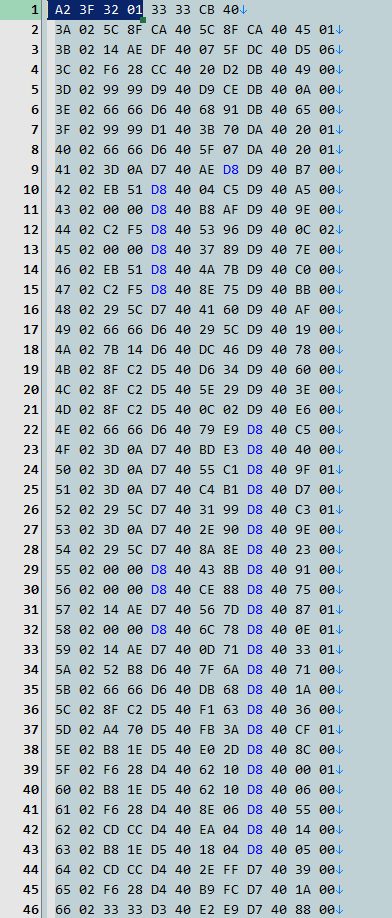

  • This is how I try to identify the individual data structures for each row.
