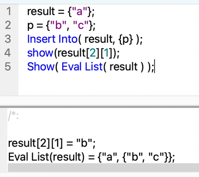

FWIW I always do it the EvalList ( ) way in your 2nd example. I guess you could do it this way, and not evaluate until you want / need to... not sure if this is buying you much (?)
result = {"a"};
p = {"b", "c"};
Insert Into( result, {p} ); //don't evaluate p here... but of course p is non-static
show(result[2][1]);    //can still access elements of p if desired
Show( Eval List( result ) );  //or can eval to see the whole thing
result = {"a"};
p = {"b", "c"};

Yes. I've used the evallist() approach and always feel like it needs a comment to explain. In my original code (link at top) I keep changing p between insertions, so it can't just insert a reference to p.
