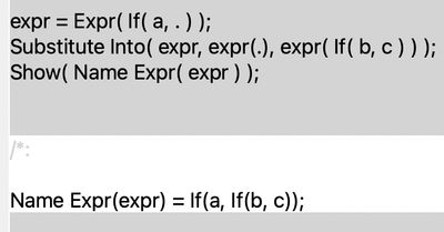

Although I am unsure, I wonder if this behavior is because the snippet "IF ( a )" is not a well-formed JSL expression. That is, the function IF takes 2 arguments, not one. JMP has no way of knowing whether "notAnIf( a )" is a well-formed expression, so perhaps shrugs its shoulders and proceeds ( ? ) Total guess on my part.
The fact the following works as you intend seems to add some support to this idea, but this does not explain why@ben_ph 's idea works, as it successfully inserts REPLACE_ME where I've got a missing.
expr = Expr( If( a, . ) );
Substitute Into( expr, expr(.), expr( If( b, c ) ) );
Show( Name Expr( expr ) );
Cheers,
Brady
