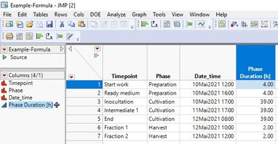

Hey everybody,
From my predecessor I inherit some data files with these kind of formulas (see also attached file):
Match( :Phase,
	"Preparation", (:Date_time[2] - :Date_time[1]) / 3600,
	"Cultivation", (:Date_time[5] - :Date_time[3]) / 3600,
	"Harvest", (:Date_time[7] - :Date_time[6]) / 3600
I would like to exchange the row numbers with dedicated Timepoints, so that it doesn't matter at what row of the table the data is.
In my head it looks like: "Cultivation", (:Date_time[:Timepoint == "End"] - :Date_time[:Timepoint == "Inoculation"]) / 3600
Unfortunately this doesn't work and I don't find any suitable code. Can you help me with it?

To get the row numbers you need, you can use Loc() or Contains functions. Below is an example using Contains()
Match(:Phase,
	"Cultivation", (:Date_time[Contains(:Timepoint << get as matrix, "End")] - :Date_time[Contains(:Timepoint << get as matrix, "Inocultation")]) / 3600,
Not exactly answer to your question, but in this case you could maybe use something like this (if you only need first and last times per Phase):
(Col Max(:Date_time, :Phase) - Col Min(:Date_time, :Phase)) / In Hours(1)

Wow, that was quick.
Thak you @jthi for your help, it is exactly what I was looking for.
As it is not always Beginn and End I decided for the following code:
Match( :Phase,
	"Cultivation",(:Date_time[Loc( :Timepoint << get as matrix, "End" )] - :Date_time[Loc( :Timepoint << get as matrix, "Inocultation" )]) / In Hours( 1 )
I chose Loc, because I understand it as Location and now it is easy readable.
