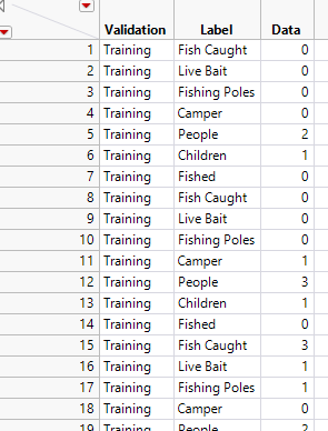

I'm trying to fit data in group and get slope and R squared number. I'm using Fishing data set as an example here.
I stacked the data so that the summary will be outputted easily as one single column then I need to spread the columns again.
So I did
fishing_stacked = dt << Stack(
	columns(
		:Fish Caught,
		:Live Bait,
		:Fishing Poles,
		:Camper,
		:People,
		:Children,
		:Fished
	Source Label Column( "Label" ),
	Stacked Data Column( "Data" )
I want to group the data by Validation column and fit (Y axis = Fish cought )and X axis are "Live Bait, Fishing Poles, Camper ...." and get the slope value and R squared number as new columns.
