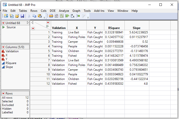

joshua
Level III
Re: How to group by and get slopes in a JSL fit model script
thanks but how can I get slope and R squared number extracted from Bivariate plots ? In addition, can we do this in stacked version of the Fish data as showed in table ?
txnelson
1. The analysis can not be directly done from the stacked data table.  In order to perform the bivariates, the Fish Caught needs to be in a separate column, and paired with each of the X Factors.  However, I think what you may want is just the output format,
and this script produces it from the original data table
NamesDefaultToHere(1);
dt = Open("$SAMPLE_DATA/Fishing.jmp");
biv = Bivariate(invisible,
	Y( :Fish Caught ),
	X( :Live Bait,
		:Fishing Poles,
		:Camper,
		:People,
		:Children,
		:Fished),
	Fit Line( {Line Color( "Medium Dark Red" )} ),
	By( :Validation )
// Create the data table of RSqares
dtR2 = report(biv[1])["Summary of Fit"][tablebox(1)]<< make combined data table;
dtSlope = report(biv[1])["Parameter Estimates"][tablebox(1)]<< make combined data table(invisible);
dtR2 << select where(:Column 1 != "RSquare");
dtR2 << delete rows;
dtR2:Column 2 << set name("RSquare");
dtR2 << delete Columns({"Validation 2","Column 1"});
// Create the data table of Slopes
dtSlope << select where(:Term == "Intercept");
dtSlope << delete rows;
dtSlope:Estimate << set name( "Slope");
dtSlope << delete columns({"Validation 2","Term","~Bias","Std Error","t Ratio","Prob>|t|"});
// Put the data together
dtR2 << Update(
	With( dtSlope ),
	Match Columns( :Validation = :Validation, :X = :X, :Y = :Y )
// Clean up the items not needed
close(dtSlope, nosave);
window("Fishing - Bivariate of Fish Caught") << close window;
Jim
