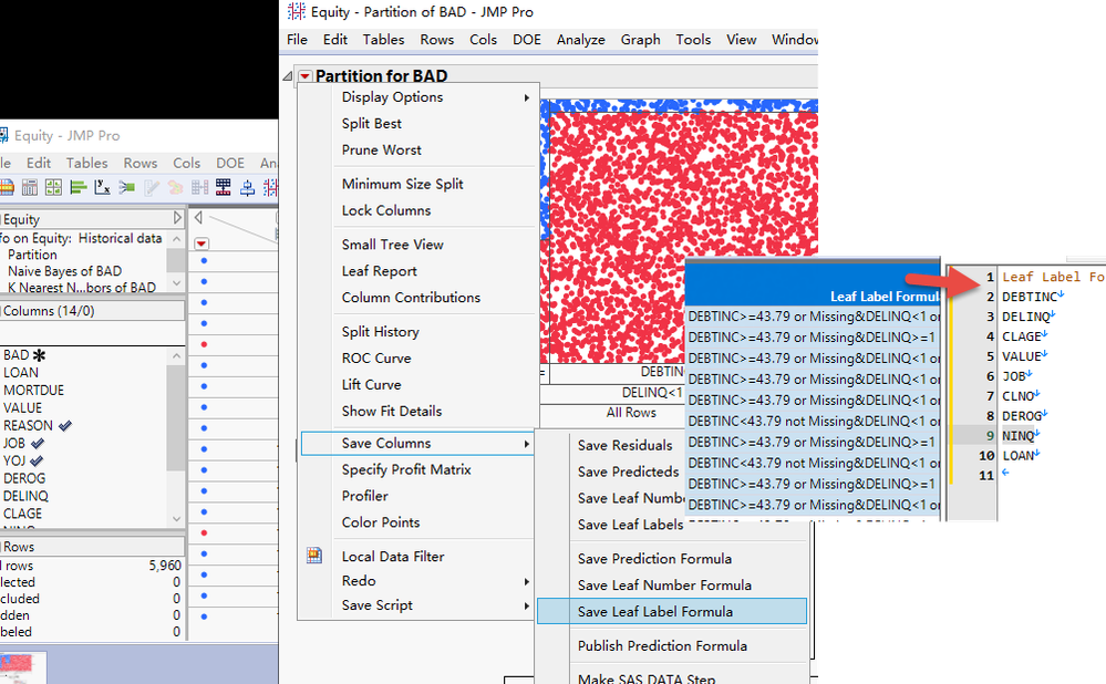

For example, use the following JSL to get the Leaf Label Formula.Extract the column names from the formula in the first 10 rows.
Thanks!
d0 = Open( "$SAMPLE_DATA/Equity.jmp" );
p=Partition(
	Y( :BAD ),
	X(
		:LOAN, :MORTDUE, :VALUE, :REASON, :JOB, :YOJ, :DEROG, :DELINQ, :CLAGE, :NINQ,
		:CLNO, :DEBTINC
	Validation Portion( 0.3 )
p<<go;Wait(2);
p << save leaf label formula;

Current Data Table( d0 );
txt = "";
For( i = 1, i <= 10, i++,
	If( i == 1,
		a = "",
		a = "aaa"
	nn = d0[i, "Leaf Label Formula"];
	txt = txt || a || nn;
tx = "ccc\!n" || Substitute( txt, "&", "\!n", "aaa", "\!n", " or Missing", "", " not Missing", "", " Is Missing", "" );
tx = Substitute( tx, ">", "\!t>", "<", "\!t<", "(", "\!t(" );
d1 = Open( Char To Blob( tx ), "text" );
d2 = d1 << Summary( Group( ccc ), Freq( 0 ), Weight( 0 ), Link to original data table( 0 ) );

You could loop over all the possible column names and if match is found, add it to associative array (and remove from the column listing if you want to)
Names Default To Here(1);
input_cols = {"LOAN", "MORTDUE", "VALUE", "REASON", "JOB", "YOJ", "DEROG", "DELINQ", "CLAGE", "NINQ", "CLNO", "DEBTINC"};
dt = Open("$SAMPLE_DATA/Equity.jmp");
part = dt << Partition(
	Y(:BAD),
	X(Eval(input_cols)),
	Validation Portion(0.3)
part << go;
part << save leaf label formula;
part << close window;
aa_cols = Associative Array();
For Each({row_val}, dt[1::10, "Leaf Label Formula"],
	input_cols_temp = input_cols;
	For Each({input_col, idx}, input_cols,
		If(Contains(row_val, input_col),
			aa_cols[input_col] = 1;
			Remove From(input_cols_temp, idx);
	input_cols = input_cols_temp;
