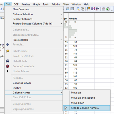

I have a table t1 with survey questions. The columns are called 1a, 1b, 2a, 2b, etc. (rows are the respondents' answers). I have another table t2 with the actual questions matching the column names of t1. How can I link the column names of t1 with the actual questions in t2? For instance, assume I do a PCA, I would like to be able to read/reference the actual questions instead of 1a, 2b, etc when looking at loadings. I am currently on version 16.

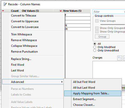

Cols menu has recode column names
And from Advanced you can find mapping
This should let you recode the columns 1a, 1b... to the questions. Other option could be to stack the data and then join the questions / use virtual join
