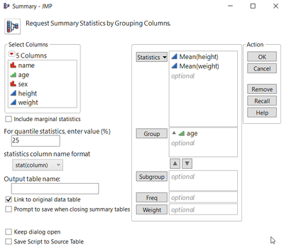

Sure but I could not find my answer there because close( dtx, nosave ); closes both the data table and summary table. I wanted to close only the data table & keep the summary table open, is that possible?
txnelson
Re: How to generate a summary average of multiple csv files?
The reason for it closing the summary table is that you specified to Link the summary table to the original table. Change or add
Link to Original Data Table(0)

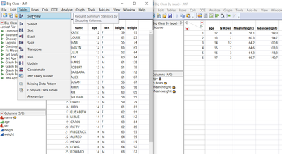

mlo1
Level IV
Did you try if Tables -> Summary function is doing the job you want?
