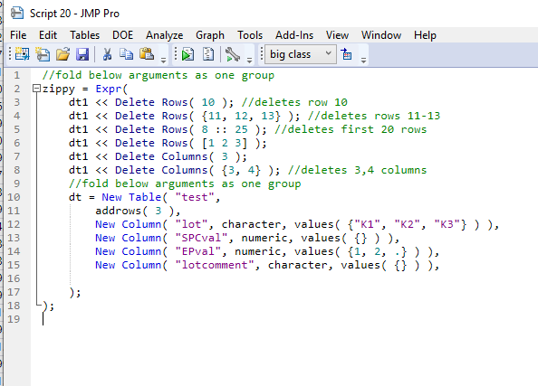

txnelson
Re: How to folding the code?
Code folding recognizes Expressions and Functions.  See below

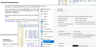

Adding a little to the reply from @txnelson, you can also add your own folding markers. The JMP Help is always a good resource.

txnelson

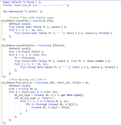

Theresa
Level IV
I see this script  has no Expr() expression, but  fold the needed content together.
Do you know how to group all the needed group by one time? Is "O-dtManu" is the  "Folding Keywords". ?
Can you show a example of how to realize below fold job?
****You can use below 3 group as a example show to me. Thank you very much.

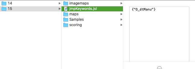

Hi @Theresa,
As both @txnelson and @ian_jmp stated previously JMP will use informative or "keywords" to fold the code at or on your preferred location within the script in addition to the defaults of Expr and Function.
For example, if you would like to fold your code on words, such as, "If", "For", "For Each Row", "While", "Try", "New Window", "V List Box", "H List Box" or even "O_dtManu" then place the words in a JSL list { } and save as jmpKeywords.jsl.
The jmpKeywords.jsl file will need to be saved to a particular directory depending on your OS in order for JMP to apply the code folding to your preferred folding words.
custom code folding keywordscustom code folding keywords
result after applying custom code folding keywordsresult after applying custom code folding keywords
The next time you start JMP and launch your script the new locations for the code folding should be applied.
