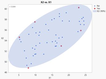

In the presence of correlation between your factors, the use of optimal designs (D-, A- or Alias-) with the covariates runs from your DoE will help select the most dissimilar and non-correlated runs.
Here is an example with 50 data points, only 2 factors (for visualization and understanding purposes) with (high) correlation of 0,644 between X1 and X2 :
You can see that the selected red points correspond to a Alias-Optimal (same results with D-Optimal design) Custom design, and are chosen to be the most "spread out", helping reduce the correlation between X2 and X1 and estimate more precisely the main effects for X1 and X2 (despite the correlation).
In this example, the choice of a D- or Alias-optimal design doesn't make any change in the selected covariate runs, but with more factors (as it seems to be the case with your DoE datasets), using Alias-Optimal designs may prevent having correlations between effects in your model and potential effects not in your model (like interactions, quadratic or higher order effects).
