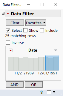

For the second one you can use data filter
You might want to create YEAR-MONTH column to make selection slightly easier

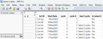

I would use this as example of latest 2 lot ID/cycle.
1. Reassign lot or Cycle by number
If( Row() == 1,
	1,
	If( :Start Date == Lag( :Start Date ),
		Lag( :cycle ),
		Lag( :cycle ) + 1
or this
If( Row() == 1,
	1,
	If( :lot ID == Lag( :lot ID ),
		Lag( :cycle 2 ),
		Lag( :cycle 2 ) + 1
Then, create this formula to label the latest xx ID or Cycle (2 in this example)
If( Col Max( :cycle ) - :cycle < 2,
	"latest 2 cycles"
Alternatively, you can modify this script to run on your data table.
However, you need to rerun this script every time the data is updated. Thus, I prefer the one above.

Here is how my test data look like

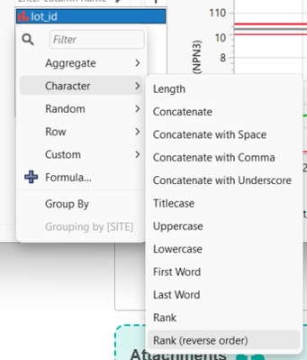

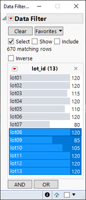

For "last 5 lots" you can use Rank Reverse:

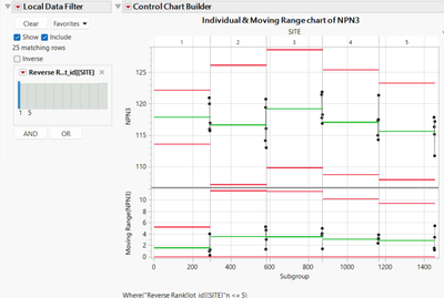

maybe even last 5 lots per "Site" - like in the screenshot?
a bit surprising: the x axis doesn't adjust to the Data Filter settings.
-> a lot of white space

Thanks! I did not know about the Rank Reverse Order function. I will try it out next week.
Yes, the x-axis problem is why I used subset instead of Data Filter.
hogi
Level XIII
Re: How to filter to show last n items/values?
actually , you are right -  the necessary function is not yet available.
Let's learn from my mistake:
Col Rank counts based on rows - not based on lots lots.
So every wafer will get its own number. -> not what you want.
Sorry.
But there is a nice outlook:
With version 19, JMP will get the new feature : )
Add dense ranking to Ranking Tie and Col Rank functions
At the moment, there is no one-click option to calculate the Reverse Score Unique.
As a workaround:
There will be another new functionality in JMP19: Col N Categories (:green_heart:)
This allows us to calculate the  Reverse Unique Score via:
(Col N Unique( :lot_id ) - Col N Unique( :lot_id )) + 1

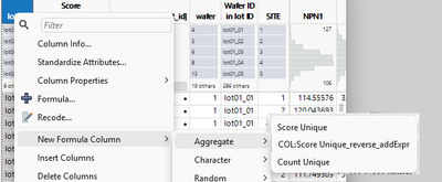

As an alternative, one can add a  Reverse Score Unique manually:
via a custom function
Add Custom Functions(
	New Custom Function(
		"COL",
		"Score Unique_reverse_addExpr",
		Function( {value},
			 Col N Unique( value) - Col Score (value) +1
		<<Formula Category( "Statistical" ),
		<<Transform Category( 1 ),
		<<Description( "Reverse Score Unique - e.g. for : the last 5 lots" ),
		<<Example( JSL Quote( New Column( "my reverse score", Formula( COL:Score Unique_reverse_addExpr( Expr(:height) ) ) );) )
with the following restrictions:
  • the grouping options are missing
  • Expr() has to be added manually in Formula Editor (to protect the argument from being evaluated too early):
https://community.jmp.com/t5/Discussions/Fast-Way-to-calculate-quot-nested-quot-Col-aggregations-lik...

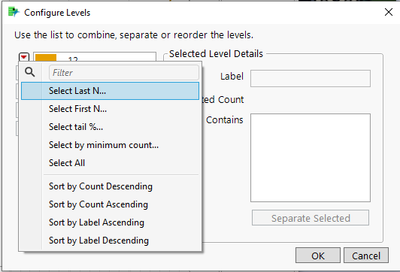

We do have quite nice "select last" and so on with configure levels but too bad, these are not accessible for (nominal/ordinal) data filters
There are plenty of improvements which data filters could benefit from, this could be one more, so maybe a wish list item for this type of selection?

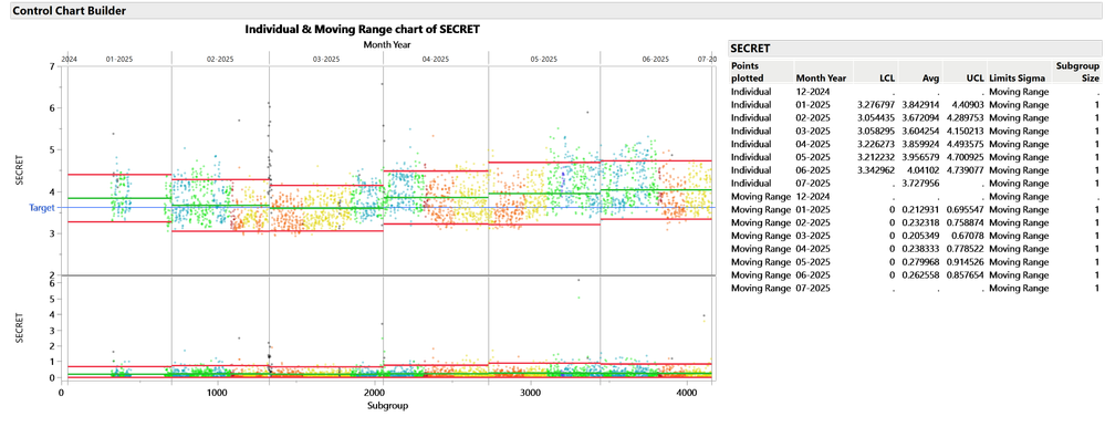

markschahl
Level VI
I used the Last.6.Months False/True formula to help create a subset. Used subset instead of filter so the subgroups in the control chart would not include the Last.6.Months == 0 cases.20250723 JMP Community Post.png
Names Default To Here( 1 );
dt = Current Data Table();
Last.6.Months.Data = dt << Subset( Filtered Rows(:Running? == 1 & :Last.6.Months == 1));
Last.6.Months.Data << Set Name("Last.6.Months.Data");
