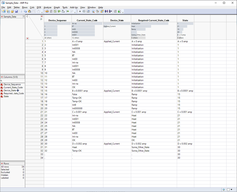

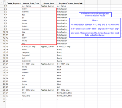

I am looking to fill/replace cell  values between two cells based on pattern/text in those two cells. Please have a look into the attached image and data.

Re: How to fill/replace text between two cells, based on specific values in those two cells
Just based on the example data provided, we don't need to know between, only starting point. Because we don't know exactly how to define Initialization and so on this example won't be using those but rather row numbers for Device_States
Names Default To Here(1);
dt = Open("$DOWNLOADS/Sample_Data.jmp");
state_rows = Loc(dt[0, "Device_State"], "Applied_Current");
states_list = Transform Each({val}, As List(state_rows), Char(val));
/* we don't know how to define values which are to be mapped so we will just use row numbers */
current_states = Associative Array(dt[state_rows, "Current_State_Code"], states_list);
new_col = dt << New Column("State", Character, Nominal);
new_col << Set Each Value(
	As Constant(
		state = "";
		ret_val = "";
	If(:Device_State == "Applied_Current",
		ret_val = :Current_State_Code;
		state = current_states[ret_val];
		ret_val = state;
	ret_val;
-Jarmo
Hi,
I have created a column "Required-Current_State_Code" - 4th Column in the data table or image.
I created a 3rd Column using "Contains()" command. This can provide start and end value of empty cells.
IF( Contains( :Current_State_Code, "amp" ), :Required-Current_State_Code = :Current_State_Code,   )
And then fill the missing values. Like Fill "Initialization" in between 'A = 0 amp' and 'B = 0.0001 amp' and so on. These filling values (Initialization, Ramp, Heat etc) are coming from another table. But number of row in between  'A = 0 amp' and 'B = 0.0001 amp' are not fixed, infect this Current value is also not fix, e.g. It can be 'B = 0.01 amp' . Only this is that it should have 'amp' in it.
Hope this will help.
	As Constant(
		state = "";
		ret_val = "";
		ret_val = state;
	ret_val;
-Jarmo
Dynamic  means -
Number of rows in between in between 'A = 0 amp' and 'B = 0.0001 amp'.
In fact  'A = 0 amp' and 'B = 0.0001 amp' are also not fixed, it can be 'AA = 0 amp' and 'BB = 0.8 amp' Only thing is we need to fill values between two cells which contains 'amp'. What value we need to fill is coming from another table.
In the give data set,
 Fill  "Ramp" in between 'B = 0.0001 amp' and 'C = 0.001 amp'
and so on.
I hope this will help.
Thanks
