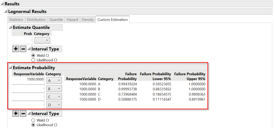

Here are the intended results:

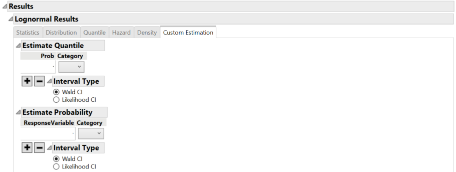

There are no errors, but nothing happens as well:

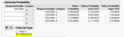

By the way, regarding the code that you showed, both of them works but I have to add the word "profile, " in front of {1000} like this one:
This code works with the JMP version I am using:
Lognormal Estimate Probability(profile, {1000}, vvv )
This code does not generate errors, but nothing happens with the JMP version I am using:
Lognormal Estimate Probability({1000}, vvv )
I am not sure whether the reason I need to add "profile" related to the JMP version I am using or not. I am currently using an older version of JMP (version 16.2).

And I missed "profile". Your observation is correct. In JMP 16, "profile" is needed. And that is to choose "Likelihood CI" type. Please add "profile" in your script.
Starting in JMP 17, "profile" is no longer required. Both Wald and Lifelihood CIs are reported.
