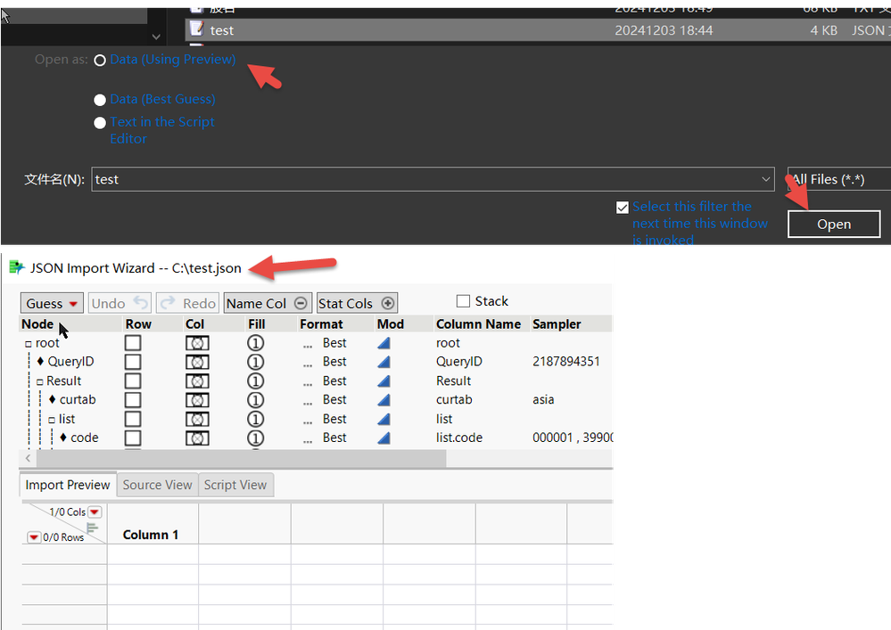

lala
Level IX
Re: How to use JSL to open a JSON file to enter the JSON import wizard interface?
Thanks!I understand that.
I turned on the auto-open interface that is needed to debug JSON data of different structures on the web.
