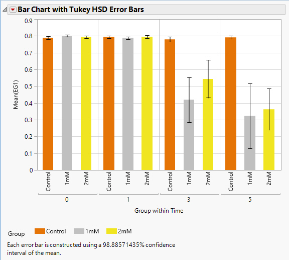

As you have illustrated I see, I can enter the data like that, Could you please let me know how can I perform the analysis and mean separation (posthoc-turkey) for eachtime point?  I'm expecting to draw a graph like this and denote significance difference at each tim epoint?

How's this?
Your Excel data were transferred to a JMP data table, which is enclosed.
The graph is a simple bar chart from the Graph -> Chart pulldown that I customized a bit to look somewhat like yours.
Dr. John W. Tukey (please note: no "r". :) may be spinning like a lathe right now, but I got the somewhat odd confidence interval number from a Mixed Model analysis of the repeated measures experiment (Fixed=Group, Random=Rep(Group), Repeated=Time Group=Group), then choosing the Multiple Comparison -> Tukey HSD, noting the Quantile and Adjusted DF from that analysis, and geting the t distribution value (98.8857...)from that.  Yeah, that's kinda gnarley and someone may (should?!) have a better approach, but there you go.  The Mixed Model analysis is somewhat more rigorous than your desired histograms, and basically say the same thing with different graphs.
Of course, this isn't the Multivariate part of the MANOVA you mentioned in the subject.  I assume you have more response variables, but didn't include them in your example?

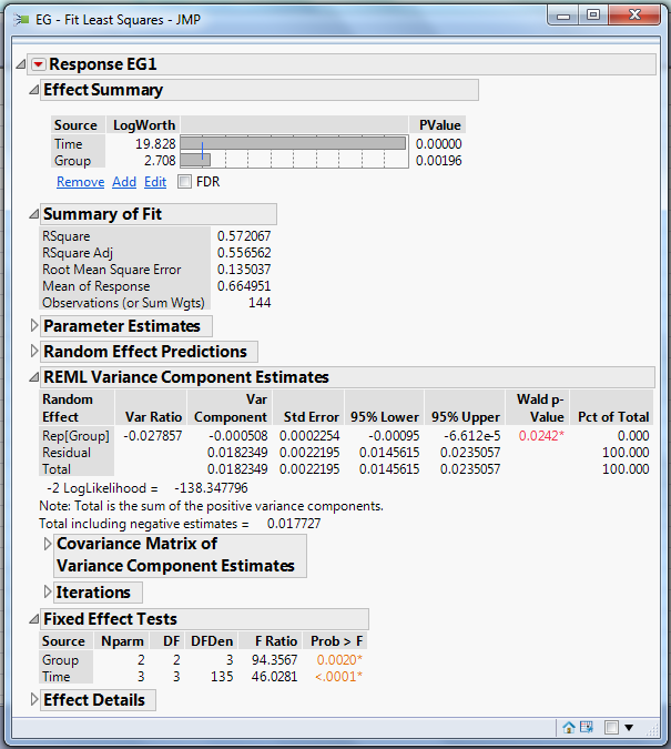

This is how I perform the analysis:
Analyze > Fir Model
EG1 to Y
Group, Rep, Time added to Construct model
Then, Rep(Group) & Random (by changing attributes to Random effect) [is this correct?]
Method: REML
Run!
Is this the way I have to perform?

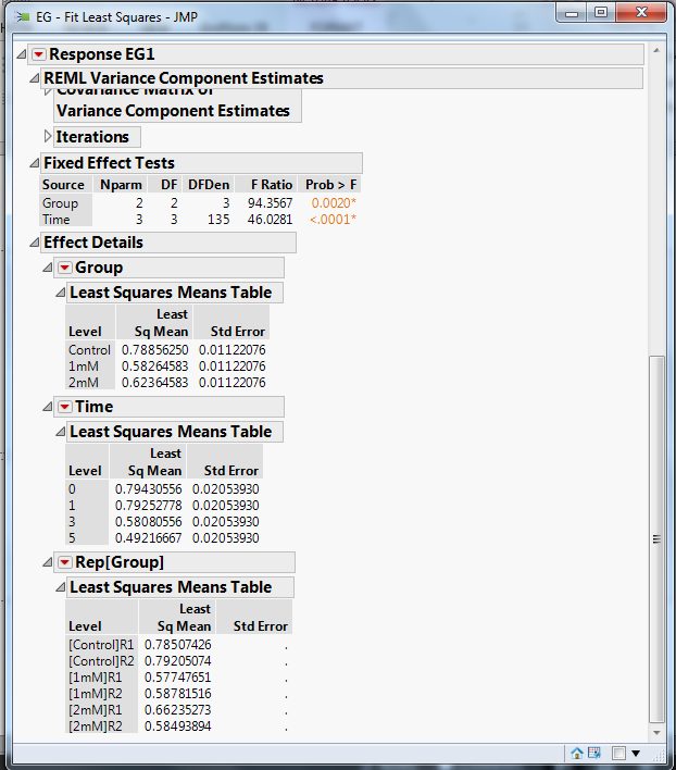

If yes, How can I proceed ahead with multiple comparision Turky?
Because my output looks like this and which button I have to click for Mean separation?
In Effect details
I want to get the mean separation for each time point separately, as shown in the graph?
Time"0": what is the mean separation of Control /1mm/2mM
Time "1": etc.
And please tell me how did you create this graph in JMP?
