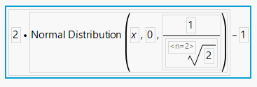

As it says in the wiki link you sent, "In statistics, for non-negative values of x, the error function has the following interpretation: for a random variable Y that is normally distributed with mean 0 and standard deviation 1/√2, erf x is the probability that Y falls in the range [−x, x].". So, a little algebra etc gives you erf(x) = the following in JMP:
