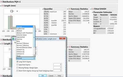

I followed your instruction and get fitted SHASH distribution but when select Capability analysis , there is no "SHASH" at the drop down list to select. Please see the picture below.

Re: How to do the Capability analysis with SHASH distribution model?
@Matthaneeya
From you attached image it does not look like you have your specification limits as part of your column properties.  This is an important step in getting capability analysis results.  The reason I am guessing you do not have your spec limits in column properties is that an initial capability analysis should have shown up with the distribution if the spec limits were in the column properties.
Right click on the column header for length(or any column of interest) and go to Column Properties > Spec Limits and enter your spec limits for the measurement of interest.  You will need to do this for any data you want to run capability analysis on.

Thank you for the recoomendation, I can do the capability analysis now.
