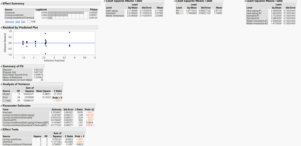

MartinY
Level III
Re: How to do T-test with multiple reponses?
Hi Jim:
I attached my results based on the example you recommend.  ( I selected some old results)
My interpretion of the results:
1.  The difference of two chemicals are signifiant
2. The testing conditions of heat aging and standard are statistically signifiant
Here problems start. For adhesion after water immersion Chemical #1 gives 2.596 KN (average) , chemical #2 gives 1.47 KN ( average), in the industry,
This difference is as night and day. Yet, in the summary, testing condition of water immersion is not listed as significant, not even listed.
How can this be solved?
Thanks
Martin
It is a
txnelson
You analysis shows, in the Effect Tests, that your interaction effect of Curing Conditions * Chemical is not significant, and that both main effects of Curing Conditions and Chemical are significant.  Therefore, your main effects can be treated as the overall results.  Because the interaction is not significant, you do not need to test for differences between Chemicals at each level of Curing Conditions.  You can simply state "There is a significant difference between the 2 Chemicals".  The same is true for the significant difference for Curing Condions.  However, because there are 3 levels of Curing Conditions,  you need to determine the sublevel differences of standard vs. water, standard vs. heat and water vs. heat.  These analyses are available under the red triangle for the individual analysis for Curing Condition.  I suggest using LSMeans Tukey HSD.  It is a more concervative test.  It will give you an analysis of which of the Curing Conditions are different from each other.
Jim

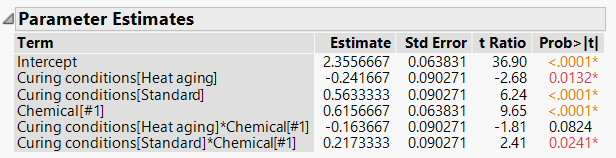

MartinY
Level III
Thanks for your very detailed explanation.
One remaining problem for me is to understand the table of Parameter Estimates.  Why curing condition " water immersion" is not listed?
and actually Chemical #1 correlation with curing conditon " standard" IS significant, which is in conflict with Effect Tests : Chemical* Coniditon is insignificant.
If I present this table, people will naturally raise these questions.
Should part of JMP output be ignored or they are in conflict with each other?
Thanks
Martin
