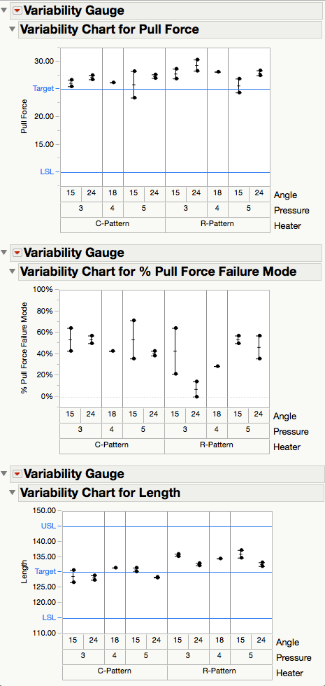

But (at the risk of telling you what you already know), I took a quick look at the XLSX you supplied, and put it into a JMP table (attached). Looks like your design was a two-level full factorial in 'Pressure' and 'Angle', with two replicates at each corner and then also a single 'centrepoint' (not actually in the centre of the design space). This pattern was repeated for each 'Heater'. You might like to look at the 'Spec Limits' and 'Response Limits' column properties. These should be useful in answering your bigger question.
Using 'Analyze > Quality and Process > Variability / Attribute Gage Chart' I made:
You didn't say how important the three responses are relative to each other. But it seems that the 'Lengths' for 'R-pattern' are always above target (which is bad), but that settings of 3 and 24 for 'Pressure' and 'Angle' give rise to much lower values of '%Pull Force Failure Mode' (which is good).

Hello Ian, thanks for the response. I added the importance to the spreadsheet. I didn't think to use the Variability / Attribute Gage Chart. I typically use the Fit Model yet it's a good way to look at the data.
