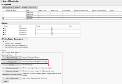

Ok, if you're dealing with computer experiments, Space-Filling designs are indeed a good way to distribute points homogeneously in your experimental space, and approximate your simulation responses with a useful model, without any assumptions on the equation/model form.
By default, if you launch the Space-Filling design platform (in menu DoE, Special Purpose, Space-Filling design) with your 4 continuous factors, the recommended number of runs by JMP will be 40 (close to your acceptable number of runs), and you have access to all design types. Since the number of factors and runs is quite low, and that you may be interested to have predictive performances, a Uniform design (or Latin Hypercube) may be appropriate choices :
Concerning the model to fit the responses, by default when you make the data table, there is a script to launch a Gaussian Proces model on your response :
This is a good default benchmark model, but you could also try other Machine Learning models using the Model Screening platform with an appropriate validation strategy (to avoid overfitting). Random or stratified k-folds crossvalidation are often chosen in this type of situation, since you don't want to exclude some points from the training.
Once a model with good performances is found, you can use the models trained on each folds and average their predictions, like mentioned here : cross validation using k-fold fit quality
If you can afford 50 runs in total, you could launch a DoE with 40 runs and train/validate the best model, and then use the platform Augment Designs (with a Space-Filling strategy) to add 10 new runs in your dataset, these runs being used as test set (final validation) for your predictive model.

The situation you describe seems to indicate that you might be interested by Space-Filling designs.
Space-Filling designs are model-agnostic design of experiments with an emphasis on predictive performances, specifically designed for continuous factors (mostly), for low-noise responses (typically computer experiments and simulations), where highly non-linear and complex response surface are expected.
If you can provide more info about the objective (predictive modeling, metamodeling, ... ?), any factors constraints, types of responses (measurement ? simulations ? variability/reproducibility ? ...), maximum number of runs acceptable, we might help you to choose an appropriate Space-Filling design type (if this option seems valid for your topic).
My first guess based on your info and objective is that you don't have any factor constraints and using only 4 continuous factors for predictive purposes (with a possible low/medium sample size less than 100 experiments), so a Uniform or Latin Hypercube design may be appropriate choices.

I am not familiar with what space-filling designs are... but from what you mentioned, it does seem like they could be appropriate. I am indeed aiming to make predictions. My results come from computer simulations, which are therefore fully repeatable. What I am looking for is an output that allows me to analyze my data in a way that helps me identify the right combination, sometimes trying to maximize certain outputs while minimizing others.
An acceptable number of samples would be around 50 (or a little more if it worth it), since I do not have an API that would allow me to automatically retrieve the simulation data and feed it into JMP.
