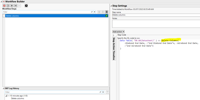

Yes. I used workflow builder.

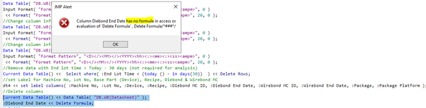

1)However, the workflow builder did not record "Delete Formula". Instead, it just recorded "Delete Columns" although I've selected "Remove formula" when the JMP Alert prompted.
2) I tried "Delete Formula" as well in my script but it didn't work.

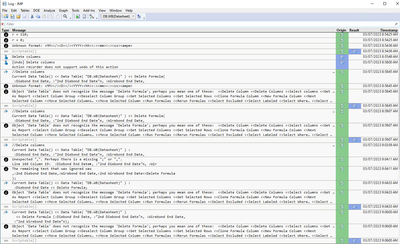

The log is as below

The script for "Delete Formula" didn't work.
Strange. It states the column has no formula when running script.
But, when I select the column manually to delete, it states "cannot delete column while it is referenced by the formula of other column"
