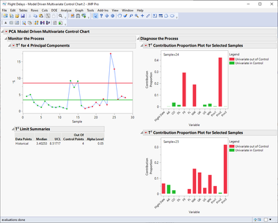

jthi
Re: Help in JSL scripting of Model Driven Multivariate Control Chart
This might give some ideas how to get going (this should be made more robust)
Names Default To Here(1);
dt = Open("$SAMPLE_DATA/Quality Control/Flight Delays.jmp");
dt << Clear Row States;
cols_of_interest = dt << get column names(Continuous, "String");
obj = dt << Model Driven Multivariate Control Chart(
	Process(Eval(cols_of_interest))
obj << T Square Plot(Save Values);
new_cols = Associative Array(dt << get column names(Continuous, "String"));
new_cols << Remove(Associative Array(cols_of_interest)); // T2 column
// get UCL (should be made more robust)
ucl_value = ((Report(obj)[OutlineBox("T² Limit Summaries")] << Child)[3] << Get)[1];
alarm_rows = Loc(dt[0, new_cols << get keys] > ucl_value);
dt << Select Rows(alarm_rows);
wait(0);
obj << T² Plot(Contribution Plot for Selected Samples(alarm_rows));
dt << Clear Select;
-Jarmo

jthi
Do you want to have final report which has the contribution plots next to the control chart?
-Jarmo
Riaz90Nawaz
Level II
Hi Jthi,
This will also work. Along with this contribution plots, I would like to add Score Plot with 95% Ellipse coverage and preferably to save the T2 values and Contributions.
Kind Regards,
Riaz90Nawaz
Level II
Forgot to add one important point. I want contribution plots only for those which are out of control limit as per the T2 Control chart

Riaz90Nawaz
Level II
Hi Jarmo,
Thank you so much. This will work.
I shall modify the code further as per my requirements.
Highly Appreciate your prompt support on this.
Thank you once again !!
