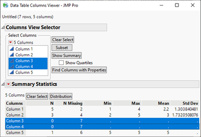

You can also use Columns Viewer (in JMP earlier than 18) to select the columns and then delete them

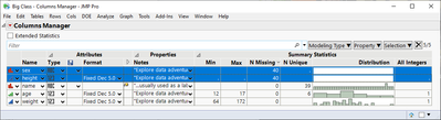

In JMP18 you have access to columns manager which might be able to do something similar (I cannot test it as I was kicked out and I don't have access to my email currently to re-verify...)

Laptop was still on so could access the email, you can perform the column selection from Columns Manager. You can even sort by the N Missing to make it even easier to select the "top" rows
