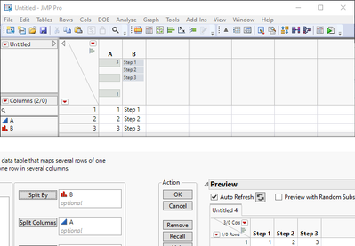

I have two columns A and B
A: Temperature
B: Step 1 / Step2 / Step3

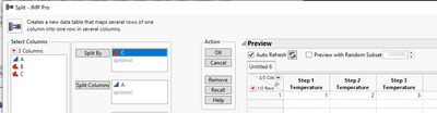

I split column "temperature" by column "steps". The final column names are "Temperature Step1", "Temperature Step2"...
How could I make final column name starts with suffix steps? like "Step1 Temperature", "Step2 Temperature"? I got a lot of columns so it is difficult to edit manually.

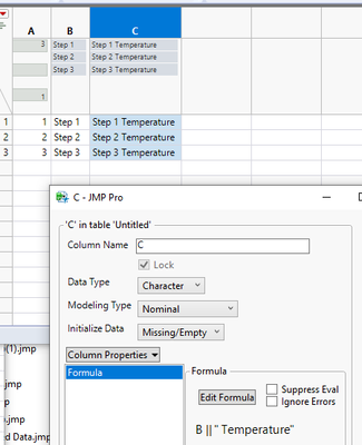

You can edit your B column (or create new) in your original data table before split (change formula to "Temperature " || :B)

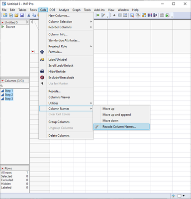

Or you can use recode column names with regex for example

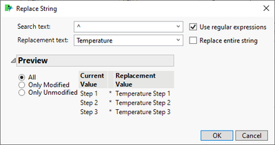

With ^ you can "replace" start of the string and then replacement text is "Temperature "

@jthi  Thanks! That's exactly what I am looking for and it works very well!
